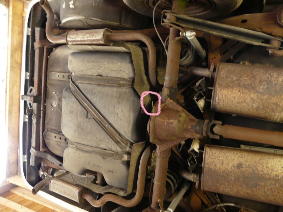

the little tag circled in the photo said limited slip additive only.

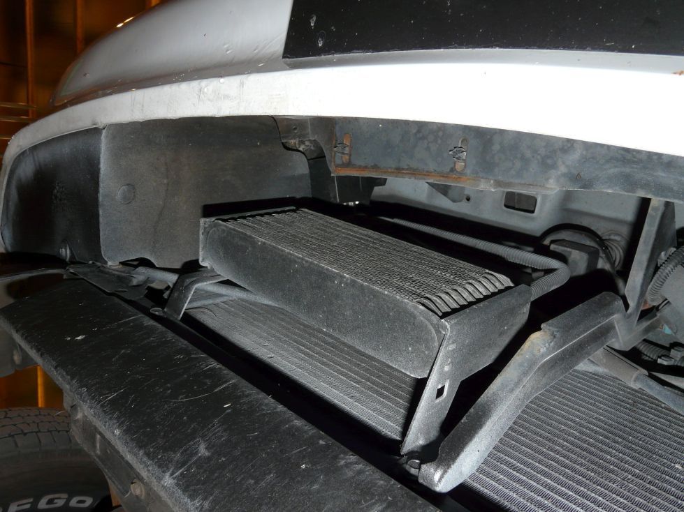

the oil cooler generally comes with a trailer package.
yes it is conceivable the gears were swapped and I do not know what is actually in there.
