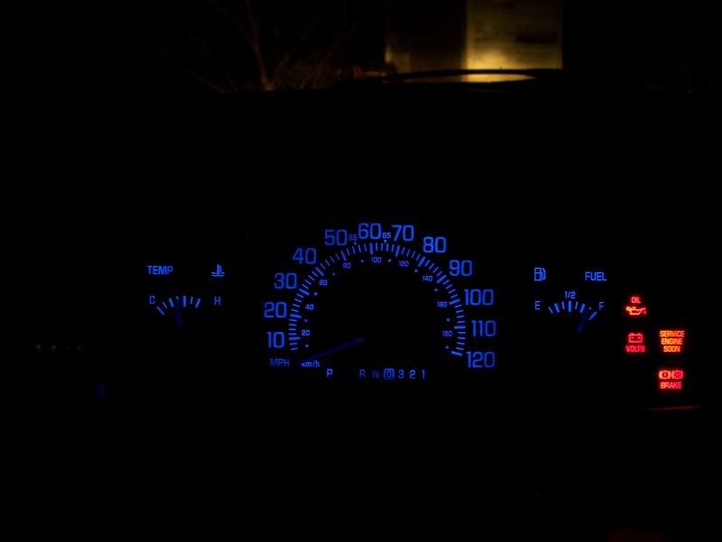

I just couldn't get over how sick I was of the factory greenish blue instrument lights. So I've started playing around with LEDS and the stock color filter which I now know, is in fact blue, and not the nasty green that shows.
I'll decide whether or not I like them later. I realized too late that the LEDS I used were not the dimming type...So I will probably redo this.
I also learned today the differences between '94 and '96 model gauge clusters. This mod will not work with the stock '94 cluster, with the parts I used.
I had to switch the circuit board over from one of my spare '96 clusters, so that the new bulb sockets would actually make contact with the factory solder points. Otherwise, the '94 cluster could work, if you were to add some solder to the 12 points necessary.
The LEDS are courtesy of superbrightleds.com
These are the blue LEDS installed, but I dare say it's almost too blue, and the needles don't stand out.
So next, I will try putting the Cool White LEDS in there and see how they look. I think that will come through as a nice lighter shade of blue, as the filter will allow. and without the yellow tint of 'warm white' the green should be more or less gone. And most importantly I belive the needles will actually glow white, instead of a damn perfectly matching color...
Given, the camera makes them seem much darker than they really are.

still looks nice even if u cant dim them.. nice mod man!

WagonLover: Thanks for the comment. They're growing on me a bit, but I'd kill for the needles to glow white, as opposed to blue.

i hear you man.. would be nice.. there's no way u can mod for that?.. put maybe a bright white light by the needles and just make the rest blue?..

I would have to modify the physical structure of the cluster to do that. Somehow mount 3 white component LEDS behind the needles.
Otherwise, there is no individual bulb for the needles alone. There are plastic reflector thingys in there that runs light to the needle from one of the main bulbs. I'm sure with a stroke of genius and a spare test cluster, I could get something to work. Smile

Lol! Not a bad idea Nick. Smile Now let's discuss getting rid of the annoying reflective glare that would cause, and we're set.

I kind of like this version.

Damn. I do too!

I do third! Smile
