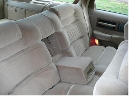

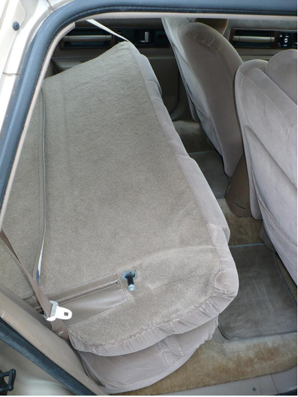

Part 1: Removing the seat:
Here's how you do it: The pivot points is where you take it off. On the passenger side (I believe), there is a "male" part that the seat pivots on. What you have to do is, push the seat away from the mount and slip it off of the shaft. When that is done just walk the seat off of the other side. It takes a little effort, but you will have no trouble. I may have the side wrong, but I think I am correct.

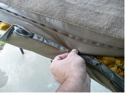

Part 2: Dismantling and reassembling:
Unzip the cover for the stock wagon seat, and remove it.  You will not re-use the foam.  You can also separate the leather from the carpeted backing by removing the stitches.  You will be reusing the carpeted back of course.  The plastic shell inside the seat is what we will be working with next.

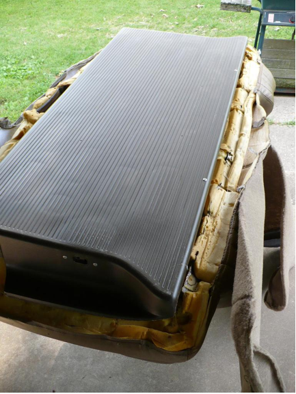

Now, it's time to fit the new sedan seat onto the plastic shell.  You will be reusing the sedan seat foam and the wire mesh that supports the sedan seat.  I did cut off the feet (where the sedan seat mounted to the seatbelts on the bottom), I may have had to trim in another spot, but it was minor if I did.
Here's what I did next, I secured the mesh to the plastic shell.  I used plastic tie wraps to do that with.  I fitted the seat on the shell, so it fit and looked good.  Each place that I secured, I drilled two holes in the shell and I would loop the tie wraps through the holes and around the wire mesh.  Secure as necessary in as many places as you think.   You may have to trim the wire mesh to fit the seat back / shell better. I can't remember if I did. You will be able to get the "feel" of it and know if it is necessary.
****NOTE:  One important step is to secure the armrest frame on the backside to the shell.  I think I bolted it with 1/4 inch bolts, just bolted it directly to the plastic inner shell, I used decent size fender washers to spread out the stress. Doing that anchors the armrest and the center of the seat.
The upholsterer may have to cut some of the tie wraps, but that's OK.  You can fix them when he's done by unzipping the back or you can give him a few tie wraps.  You've done the hard part.
To give you an idea of how long it takes, maybe an hour or two.  It's easy.
Part 3: Off to the upholsterer:
What you need to bring:
1. The new seat back
2. The carpeted back from the wagon seat and the old leather seat back (the upholsterer will need to cut two small pieces from it to match and patch on the new seat, one on each side).
3. Some extra tie wraps.
NOTE 1:  Explain to your guy that you need to maintain the pivot point holes!
It should be an easy job for him. I was charged $60 to finish it, I gave her $80 as I felt she didn't charge me enough.
NOTE 2: make sure the pivot thingies are secure.
****As you probably know, the rear seat won't fold down as flat as the stock seat.  But that's OK, you can still carry stuff around.  Eventually, I was able to find another stock seat back.  So, if I had a heavy load, I just swapped seat backs.  Actually, I have probably done that once, maybe.
Good Luck, you're on your own! Ha Ha

I just did a big update on my Roadmaster Deer-Strike thread in the General section, and am doing the Sedan seat swap as part of the repairs/mods. I posted a lot of pics and what I did/found in that thread if you want to see, here's the link, and the seat mod is down near the bottom: http://gmlongroof.4umer.com/t12279-wagon-travel-and-deer-strike-pics#132069
The seat is at the upholstery shop now getting the carpet from the wagon seatback sewn on, but I posted lots of pics of how it got to that point. Will update once I get it back and get it installed.
-Texas Mike
Posts : 9833
Do Sedan Seats fit in a Wagon? Empty
PostSubject: Re: Do Sedan Seats fit in a Wagon?   Do Sedan Seats fit in a Wagon? Icon_minitimeThu Apr 21, 2016 11:15 am
Can you see the difference in Sedan and Wagon seats?
Do Sedan Seats fit in a Wagon? 13055948_10209278805957865_7369648998788565165_o
Do Sedan Seats fit in a Wagon? 13063424_10209278808357925_8381189501429505097_o
