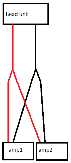

Here's a crude schematic of my plan. Will I have to upgrade the alternator or not?
Question about battery cables Schema10
I'm going to get two RCA splitters, one for each channel, then from those run 3-foot RCA cables to each amp.
Question about battery cables Schema11

Here's what you do (once you get your car) Don't over complicate things here yet. work with what you have and upgrade as you like. you already have subs and an amp right? go to walmart, buy yourself a decent head unit and a wire kit. wire kit is probably something like 50 bucks, an okay head unit $150 or less. you don't need 30 feet of rca cables. I bought a set of 20 footers and had too much. dont even bother thinking about upgrading your alternator yet. wire it up and have fun. that simple.
My first ride was an estate too and I also had old car audio stuff kicking around (and still do lol) my subs were really old 2x JL 10" subs in a box that I got for free. because of the age and specs (I forget what their ratings were) I could only run a very small amp 300-450W I think is what I had. didn't really give a **** because the bass still bumped even with my cheap little setup. before I hooked it all up I had big plans to upgrade but once it was all said and done, I really didnt feel the need too. and trust me, when you finally get your wagon their will be lots of other stuff to spend your money on.

OK. Thanks for clearing up some things for me. I might not upgrade my alternator because dimming the lights in the cab could be funny. bounce bounce

With the audio stuff you have, you won't need to worry about dimming any lights, but what's the inverter for?
