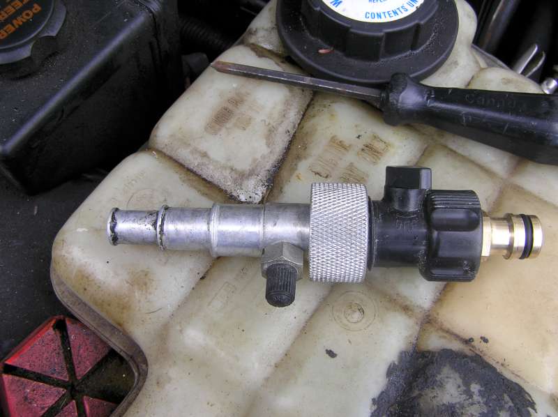

The first thing you will need is an adapter to connect a garden hose to the heater hose. You can pick up one of these (or similar) at any auto parts supply shop:
(I added the brass quick-disconnect to match my garden hose). There's some plastic "tee" fittings around too, but they are inserted permanently and I'm not a big fan. The one pictured is aluminium and features a Schrader valve fitting for those really stubborn clogs.

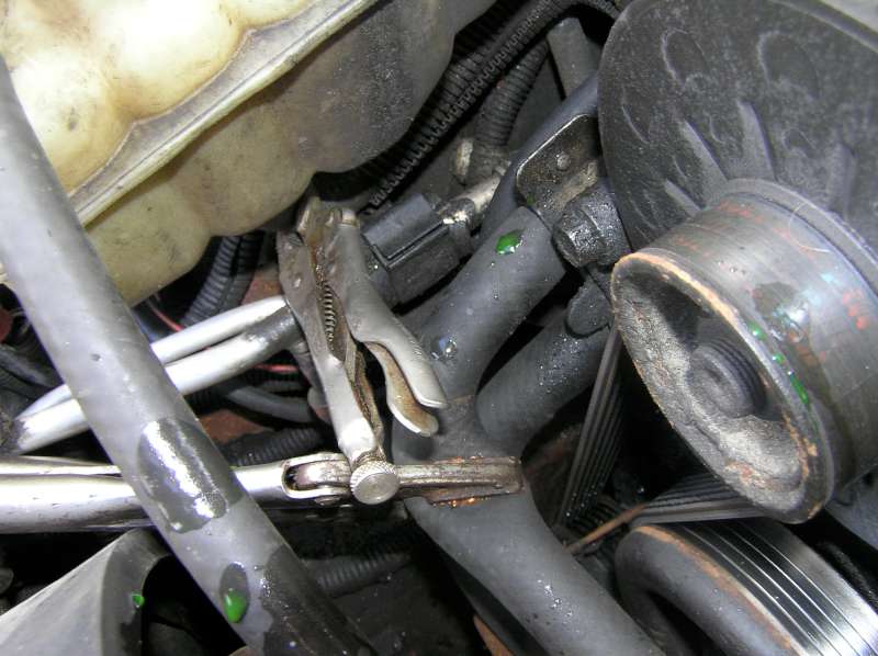

Unless you are draining and refilling the entire cooling system, you can pinch off the engine side of the hoses to minimize coolant loss. You can buy special clamps for this purpose, but Vise-Grips work well too. Three are required for the LT1 -- the two from the engine and the one under the reservoir.

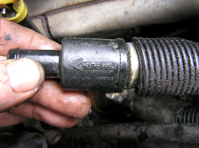

Separate the supply hose by releasing the hose clamp down stream of the black plastic restrictor and gently twisting the hose a bit while pulling it straight back. You shouldn't use a lot of force and you should pull straight back to avoid cracking the plastic nipple. The restrictor is labelled with an arrow showing the normal flow direction.
If you look inside, you can see the 1/4" restriction. It's there to control coolant flow at high rpm. Obviously it would also minimize flow during flushing, so we want to be down stream of it:

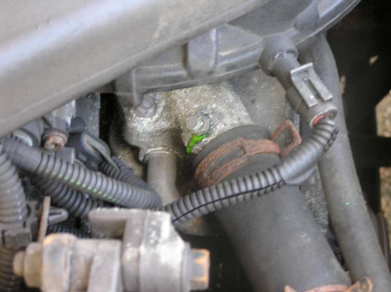

When you are happy with the results, shut off the water, disconnect the adapter, drain the heater core (you can gently blow into the return hose to facilitate this) reconnect the two hoses, release the clamps and add about 1 cup of pre-mixed coolant to the reservoir. Crack the bleeder valve on top of the thermostat housing (pliers are probably required) to bleed any air bubbles and run the engine for a couple of minutes before shutting off the bleed valve (CAUTION: if your car is a tow-pack model, your hand will be perilously close to the mechanical fan. DO NOT ATTEMPT TO OPEN/CLOSE THE BLEEDER VALVE WITH THE ENGINE RUNNING.) Close the bleeder valve securely, but don't crank hard on it -- it's pretty tiny and easily damaged by too much force.
