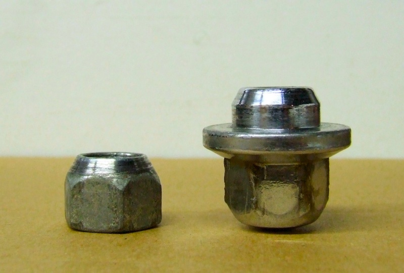

" />http://gmlongroof.4umer.com/t12095-hi-from-a-longtime-roady-wagon-driver
Above is a picture showing the lugnut for the wheels I have, and a conventional steel wheel nut. The turbine lugnut shows a taper on the end. I’m fairly sure the reason for this is so that it can be also used on a steel wheel (spare tire). I have been unable to find a part number for either the chrome or cadmium turbine nuts.
For reference, the thickness of my wheel, measured from the back of the wheel to the bottom of the washer indent is .775 inch. The washer indent is .130 inch deep, making the total wheel thickness .905 inch at the raised “bosses” at the stud holes.

The center cap on my wheels is from a Corvette. Buick emblems added.
Your acorn nut is a steel wheel part, aluminum wheels should use a "bulge" seat acorn:
You can run the narrow steel acorn nut, but the hex parts will cut into the wheel a bit.
