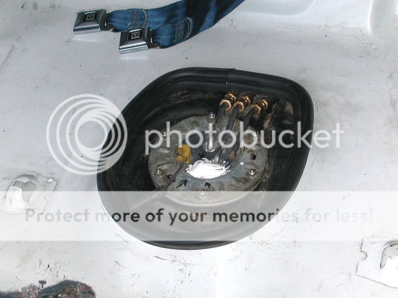

The crack around the vent pipe had a lot of fuel staining around it, so I filled around it with white marine-tex epoxy...

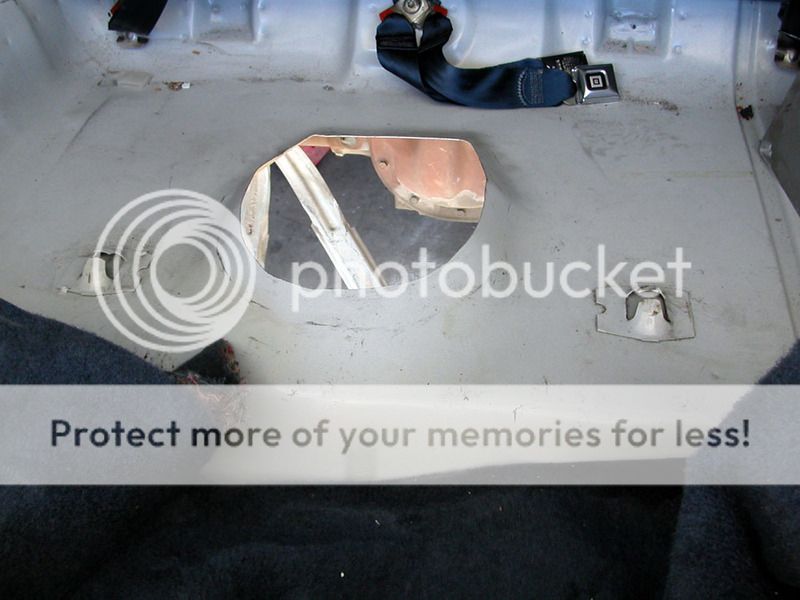

this shows the hole I cut from the top of the dome, leaving side walls that position and fit the cover piece I robbed from a donor car...
[/URL

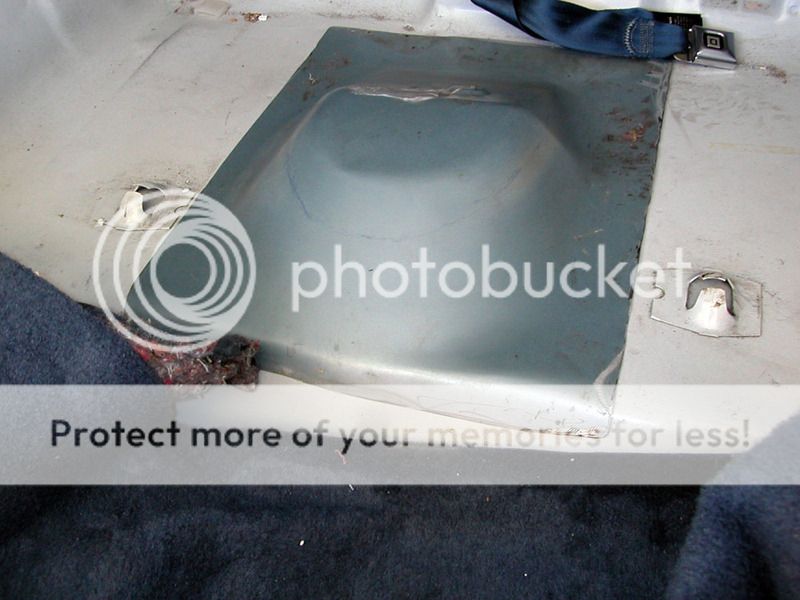

look how nice the cover piece sets over the hole and lays flat.... It can't slide around because the walls around the hole fit inside it like a glove...

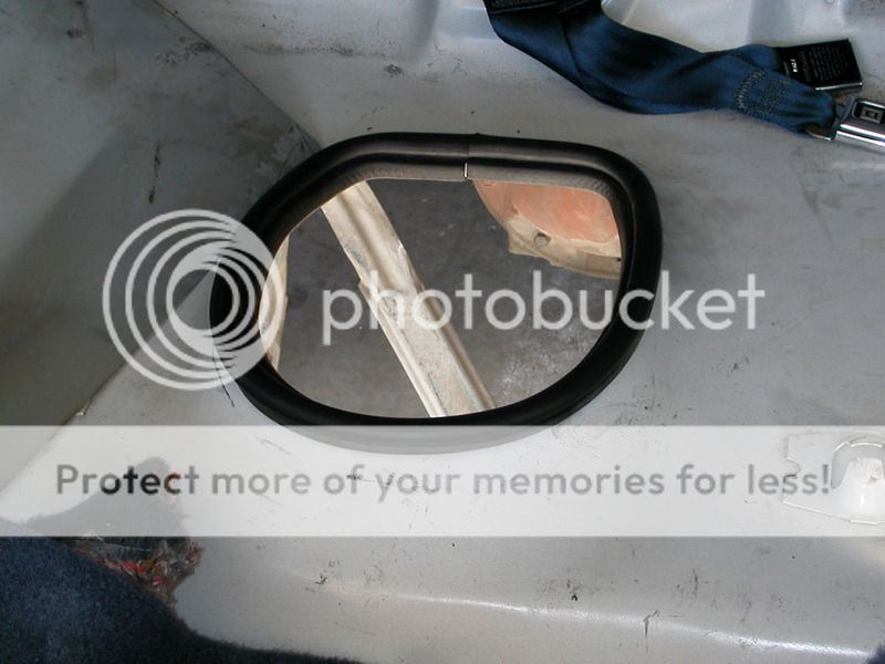

I snatched all the door seals from the donor wagon and cut and fitted this piece clipped around the inside of the hole..

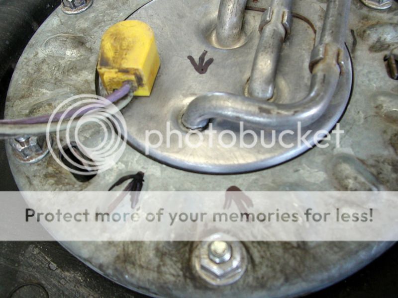

Look how nicely the hole fits the module with plenty of work space to r&r the pump...Also notice the compression fittings installed in the lines that eliminate the need for a bigger hole...

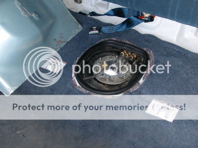

with the hole cut in the carpet, the seal sticks up far enough to seal to the inside of the cover piece with it st on top of the carpet..... The seat foam holds the cover down snugly enough to seal and there are no fumes..... How do I know?..... Well..... There is still a leak on top of the tank near the left strap rail pocket when the tank is full... I can't smell it inside the car with the doors shut, but I can smell it when I open the door....

Not quite sure I follow how you attached the compression fittingspump tubing. Did you cut off all the GM fitting that are folded onto the tubing? What did you do at the filter, and forward from there?
Have you had any leaks since. I'm about to replumb ALL the fuel lines, and am gathering notes.
AzDon
Posts : 316
Join date : 2011-08-05
Location : Lake Havasu, AZ
PostSubject: Re: F**ck#n fuel pump (again)   Wed Apr 05, 2017 8:11 am
I just cut the metal tubes close to the module so they could be did-assembled through the dome hole..... I still kept the full length of the tubes with the factory ends so that all the hoses are the factory stuff..... the compression fittings use two brass ferrels slid onto the tube on either side of the cut, then compressed by the two nuts....NO LEAKS!.......
