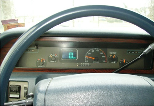

Posts : 3085
PostSubject: Re: 94-96 Dash in 91 Wagon   Tue Jul 12, 2016 10:04 am
Is that similar to what you are running,Dave?

Posts : 3877
PostSubject: Re: 94-96 Dash in 91 Wagon   Tue Jul 12, 2016 8:55 pm
Yes Andy, same model ,with the minor exception being that I went with the red version.
The difference in the "Street trend" version is that someone else fitted it into the cluster shell for you, and charged a couple hundred extra to do so.
i did not find cutting the shell up with a Dremel tool that intimidating of a deal, I have pictures of the process on my hard drive Though the wiring might be more than some want to tackle, all it took was a set of modular connectors from Radio Shack and some mounting hardware. Pinning the connectors is a pain in the butt.

PostSubject: Re: 94-96 Dash in 91 Wagon   Wed Jul 13, 2016 8:41 am
The "Streetrends" dash is a Dakota Digital unit.
http://www.dakotadigital.com/index.cfm/page/ptype=results/category_id=423/mode=cat/cat423.htm
They make a version to replace both sweep speedo and tach dash...
Posts : 3877
PostSubject: Re: 94-96 Dash in 91 Wagon   Wed Jul 13, 2016 9:14 am
Same thing for all practical purposes. You can get the intellitronix from from Summit  for under $400.00. Personally, I like the six gauge cluster better from Intellitronix, as compared to the five gauge unit from Dakota Digital.
https://www.summitracing.com/parts/izl-dp10002b/overview/

This was from my earlier post. I have a number of pictures on my computer as to it was done. It fit into the plastic box that holds the factory dash nicely. I blanked off all the idiot lights.
