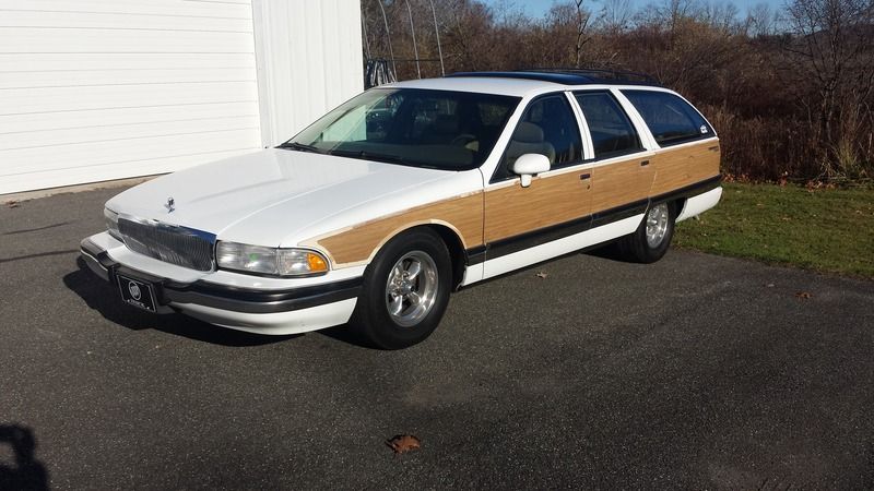

1994 Buick Roadmaster Estate Wagon 125k miles with the LT1 5.7 V8 - 260hp / 330 tq
Rear end has been upgraded to an Auburn Posi unit with 4.10 gears in 2015. ABS light is on because with these gears you lose the tone wheel in the rear
4L60E transmission was replaced in this car back in 2015 from a vehicle listed with 18k miles on it, vehicle had already had a reman AC Delco transmission installed so it has even less miles than that on it. Installed deep transmission pan.
P235/70R15 front tires, P275/60R15 rear tires and Halibrand wheels (look identical to Torque Thrusts)
Hypertech Programmer power tune installed and was needed to change tire size in PCM due to tire size change. Shift points also changed for better performance
Hypertech 160 degree thermostat installed
Factory mechanical fan removed and 2nd electric fan installed
Air Pump and all emission tubing removed. Plugs installed in both manifolds.
Both air intake resonators removed, they call this a first base and home plate delete
K&N Air filter in factory housing, housing opened up for more air
H.I.D. headlamps
VATS key bypassed with resistor
2" Lowering springs all the way around, Air Lift air bags in rear springs
Factory dual exhaust with cats removed and mufflers replaced with Rush Performance mufflers
Minor exhaust leak at the rh manifold to front pipe
Interior is in good condition, no major tears anywhere. One tiny puncture in drivers seat.
Trim piece missing on drivers door panel, panel has crack
RR window inop, switch is broken in up position, may only need switch which i have
Headliner in very good condition
Factory cassette radio, electric antenna works
Missing rear wiper arm
Some rust on rear 1/4's, especially on rh side, bottom of spare tire well is gone
Dent at front of passenger door, and larger dent on passenger rear 1/4 panel
Floors and doors are all solid
Glass is all good
I have a replacement trim piece for the passenger 1/4 if it was to be repaired
Much of the vinyl woodgrain on the moldings are peeling off which is very common
One of the mounting points for the grille is broken, otherwise chrome is in very good condition
New front brakes installed earlier this year
New sway bar links installed this month
New coolant temp sensor for gauge in dash installed last month
A/C in need of a recharge
Check engine light on for O2 sensor
Oil cooler lines were leaking, swapped oil filter adapter for a vehicle without oil cooler lines and plugged off lines up by radiator.
Oil leak at rear of intake manifold, very common on LT1's
Car has been on synthetic oil since purchasing it in 2014. Only put 3k miles on it in that time.
Car has gone as fast as 14.67 @ 93 in the 1/4 mile @ Lebanon Valley Dragway in Sept 2016.
Finished in 3rd place in Street Eliminator @ Lebanon Valley Dragway this year with one race win.
Runs and drives great, just took it on a 150 mile drive this past weekend.
