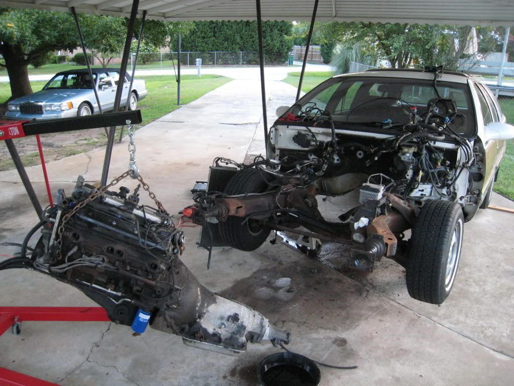

I have one (factory) installed on my wagon....engine came from a SD parts wagon.  You can kinda see the heater cord wire coming from above (and forward) of the oil filter in this pic. Goes up behind the engine and you can see the rest of the wire/plug coiled on the top.
I unplugged the plug and the freeze plug is still there...I'll never use it here in SC.
