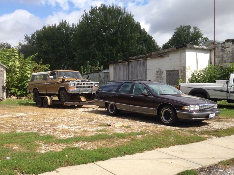

[url=
Here it is shortly after buying it. Thing tows like a dream!
Posts : 2910
PostSubject: Re: My long-term 94 caprice build...   Thu Jan 26, 2017 10:05 am
Looking good!

PostSubject: Re: My long-term 94 caprice build...   Sun Feb 05, 2017 1:20 pm
I really like that towing picture.
