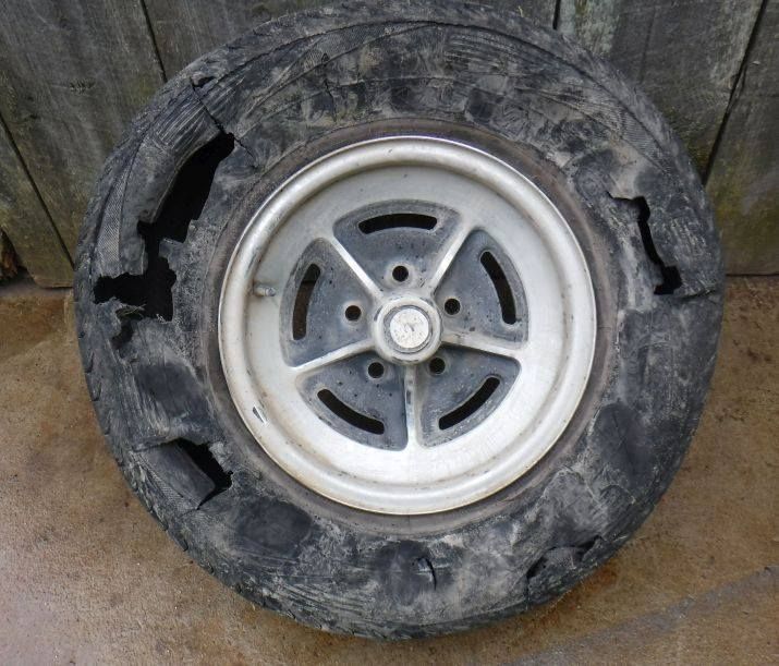

Yesterday, while on my way to a DR's appointment, this happened.
The tires are all of 2.5 years old. I realize this can happen to any vehicle, but this is the second blowout on this car. Sad

1. What tires are they?
2. What are the date codes on the tires?
3. What pressure do you run, and how often do you check it (honestly)?

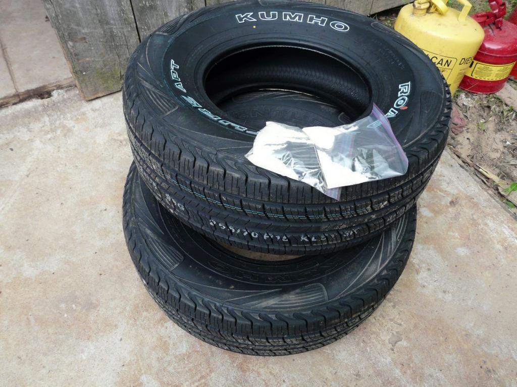

(2) 255/70R-15 Kumho Road Venture APT KL51 (REAR)
(2) 235/75R-15 Kumho Road Venture APT KL51 (FRONT)
I THINK they were purchased just over 2 years ago but cannot verify till I get home. Possibly 3 years ago at the most. (new online)
I will try to get the date codes but I assume they are less than a year before I purchased them.
all big old school 15" tires I run @ 32 PSI. these tires were checked/filled just over 2 weeks ago.
I try to check every month or so but it can be as long as 3 months.
PostSubject: Re: Back for a while I think.   Wed May 24, 2017 11:28 am
I'm guessing here...rear tire? Passenger side?

PostSubject: Re: Back for a while I think.   Wed May 24, 2017 11:31 am
rear drivers side.
PostSubject: Re: Back for a while I think.   Wed May 24, 2017 11:42 am
Rear tires are prone to getting driven on while low on pressure more often than fronts. This is due to the driver not being able to 'feel' the pressure difference as well as a front tire. And rear tires are also more prone to catching objects that can cause a puncture that can potentially cause a pressure leak. Heat builds up fast in a low tire (especially at higher speeds).

Wow, that's both scary and annoying! Was this due to a puncture or just a random blowout?

PostSubject: Re: Back for a while I think.   Wed May 24, 2017 1:59 pm
You could check tire pressure as often as you like, but if you pick up a nail or otherwise puncture the tire and loose air 10 minutes later, even on a short trip you can blow them out from underinflation and heat. Nonetheless, if it happens a third time, I'm staying away from you in thunderstorms.

PostSubject: Re: Back for a while I think.   Wed May 24, 2017 2:42 pm
While I don't have the tire off to check for a puncture, I believe the sidewall gave way on its own.
It started making noise and as I was slowing down it blew out.
I believe it was a manufacturing defect and not a road hazard, but have no way to prove it.

PostSubject: Re: Back for a while I think.   Thu May 25, 2017 5:10 pm
32 is to low inmho for such a big heavy car
I run 38 rear 36 front on the 15" tires
The 17's i run 40 all around

PostSubject: Re: Back for a while I think.   Thu May 25, 2017 8:18 pm
Perhaps the replacements will be a major brand.
Can't say I have ever had a blow out like that in fifty years of driving. Been running BF Goodrich for most of those years, once the tires that came with the car got thin.

Posts : 3173
PostSubject: Re: Back for a while I think.   Fri May 26, 2017 10:07 am
The lower tire pressure,combined with tall sidewall,streched over a 6"wide wheel,must have created some squat/bulge in the tire. Was rubbing an issue?

PostSubject: Re: Back for a while I think.   Fri Jun 09, 2017 9:18 am
Pretty paranoid about tire pressure now. I paid to have it mounted this time, due to health pain issues. hopefully this one will not be a problem.

Posts : 5798
PostSubject: Re: Back for a while I think.   Sat Jun 10, 2017 11:10 am
What pressure in the new tires?

PostSubject: Re: Back for a while I think.   Sat Jun 10, 2017 11:20 pm
I am taking the suggestions to heart and bumped the rears up to 36.

Manufacturing date code?
A few pounds of pressure off spec, either way, won't cause a blowout on a modern tire.
