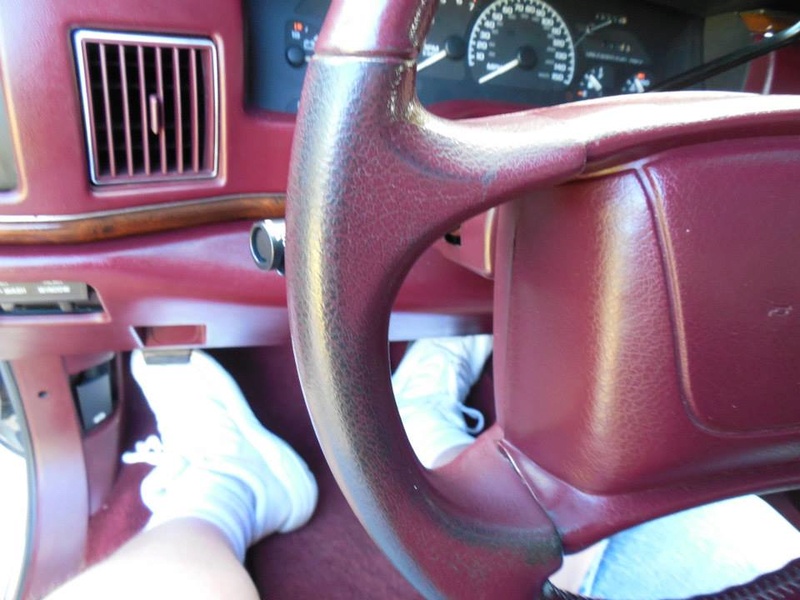

Howdy all,
A couple of questions. Here's my issue:
My recently acquired 95 RMW's steering wheel is extremely worn and worsening. On top of that; the horn doesn't work. I bought a new grey airbag. Would SEM(?) interior paint would work to color match it to beige?
The major question though. Will 1995-2002 S-10 or Full size truck steering wheels work. I would like a direct plug and play bolt on to replace my worn factory wheel while I search for repair solutions.
I've searched, nothing solid. I just want a bolt on wheel with no clock spring issues and a working/ compatible airbag
Thank you!!

Question 1. Yes,SEM the whole thing,done.

You are not supposed to paint the airbag. I think that if you look carefully on the airbag, you may find a sticker that tells you that, or perhaps it’s in the FSM. Why? I’d guess that heavy paint could flake off at high speed if the air bag deploys, or possibly the solvent in the paint could weaken the cover. Just a guess, but I think, myself, I’d probably paint it.
I used SEM rattle cans, to paint my entire steering wheel, as I found an exact match. I covered it pretty heavily, with repeated coats, then sprayed 3-4 coats of clear over it. I let it dry 3-4 days before use. It looks good and has held up quite well.

Even over the top and bottom leather part?
Years ago I painted an A-pillar gauge adapter with some kind of interior mixed aerosol applicator, it turned out awesome because I took my time and put several coats on it. If the leather part is safe, I'm going to do it.
I'll test that paint on my original air bag with the failed horn switches, then hit with 12vdc to deploy the airbag, should be pretty cool way to test the paint.

Make sure you use SEM on the leather. They make a couple of different coatings. The Color Coat is for vinyl and hard plastic. Classic Coat id for soft vinyl and leather.

I think I might risk a 1998 or older S-10 steering wheel while I attempt to restore my original wheel and the new airbag.
I'll report results as they happen. Thanks for the heads up on the SEM paints.

Quick update. I got a replacement wheel from Buicknut that was in much better shape. I started to restore it by cleaning it up per SEM instructions using the soap and then the aerosol prep. About 10 coats of Color Coat applied. Giving it time to cure before pulling the masking off the leather part. Then I'll mask up the recently painted areas while using Classic Coat on the leather.
Before prep (pic Buicknut sent actually):
After several applications of Color Coat:
I'm really happy with the results so far. We'll see how the next major step goes.

Sorry just seeing this now, but my 96 wheel was re-dyed with SEM too.   Did the entire wheel and it came out great and has lasted over two years now.
I HATE that GM went to these "dyed" black steering wheels, with half plastic and half leather, but they did so we deal with it.   The SEM stuff works!
BEFORE:
AFTER
Well worth the effort!

Final steps completed. Color Coated the plastic and Classic Coated the leather insert. The colors chosen were Saddle Tan 15033 for the plastic and Medium Prairie Tan 17063 on the leather. Not too shabby. We'll see if it how it holds up once installed. The shades don't perfectly match each other. So if I would do anything different the next time, I'd choose a much darker version of the Classic Coat for the leather insert to contrast against the plastic. Which I might do on the original wheel installed in the car after I swap it out for this fixed up wheel.

Sam did you paint the air bag iteself to match the wheel spokes? I didn't on my Roadmaster, but did on my 95 Park Ave.
Brandt51
Posts : 97
Join date : 2017-08-14
Location : Las Vegas Nevada
PostSubject: Re: 1995-96 RMW Compatible Bolt-on Steering Wheel   Thu Sep 14, 2017 1:57 pm
I elected to not paint the air bag. I got a replacement beige one from Buicknut. The airbag I got in the wrong color from eBay only has one side of the horn working, so decided not to bother with it. I'm going to test the airbag function next time I go to the range though.
