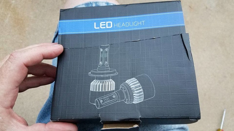

Ebay LED lights came in yesterday.

Lights are in a triangle shape, with two sides lighting up for low beam, and the 3rd side coming on for high beam.
