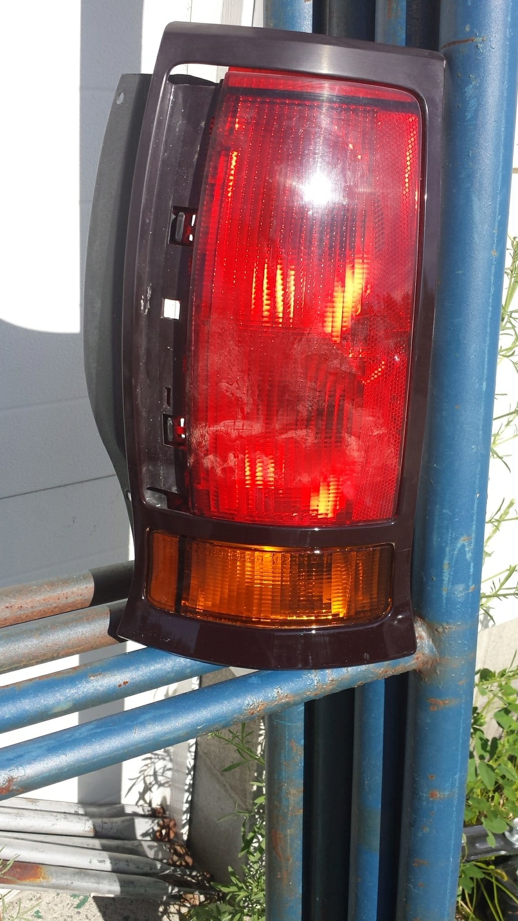

Check this out. I even got the amber reverse light coloring down. I haven't cleared whole light yet but it's part of the plan.

Tinted clear on the reverse?
Posts : 2078
PostSubject: Re: Tail Light Restoration?   Fri Jun 15, 2018 4:34 am
HOK Kandy mixture
