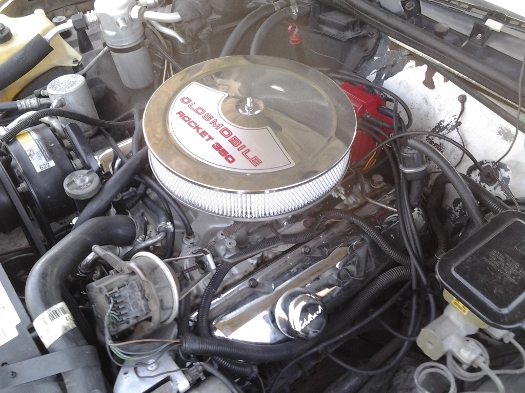

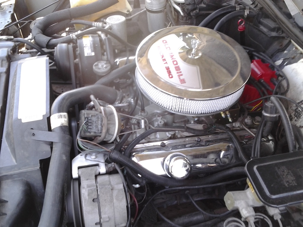

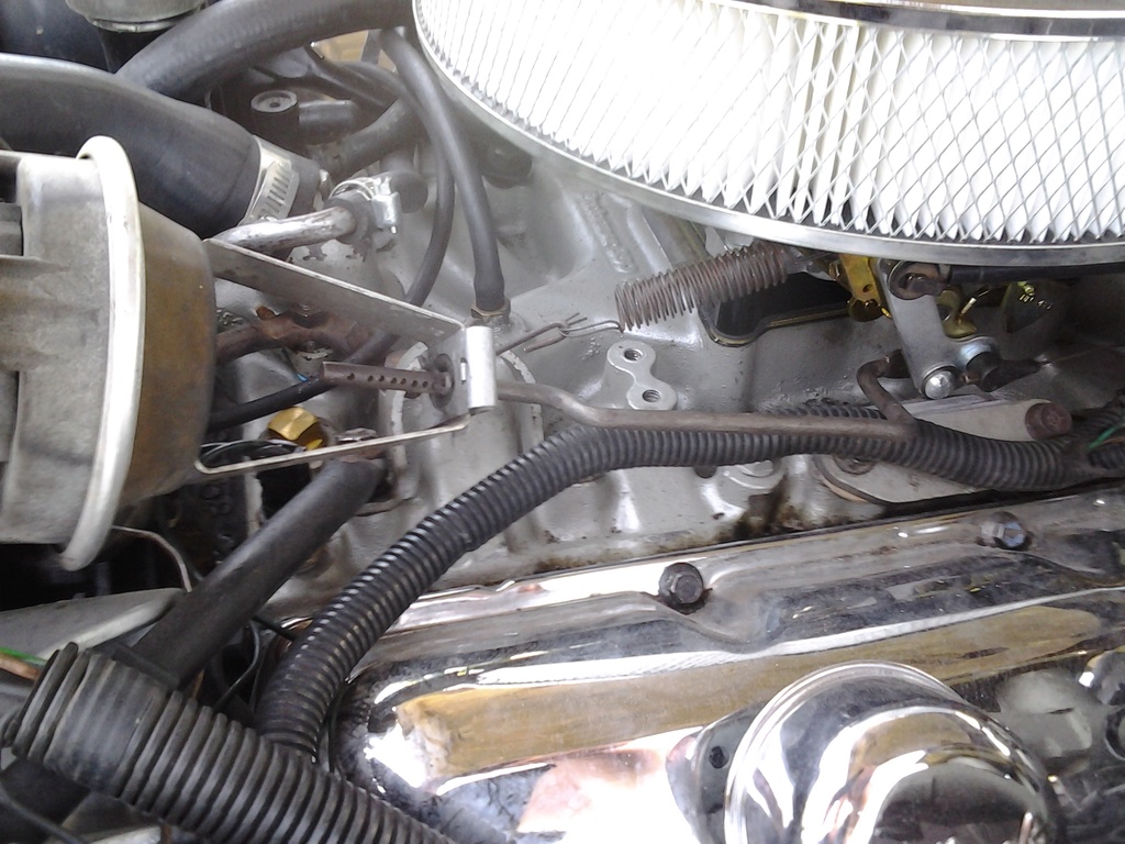

I did the Olds 307-to-Olds 350 swap on my 88 Cutlass, and I never could make the stock computer-controlled-carb work correctly on the 350...I did try for a week or so before getting frustrated and changing plans.
I ended up removing the entire computer, harness, and pulling the Check Engine bulb, and going with an Edelbrock 650 carb and Performer Olds 350 intake from Summit Racing, an aftermarket distributor, and installed the aftermarket lockup kit for the stock 200R4 trans.  I also removed ALL the smog-related vacuum hoses, smog pump, and EGR nonsense.   That solved EVERYTHING and the Cutlass ran like a scalded dog after that!
I re-used all the stock brackets, but did locate a set of Olds 403 exhaust manifolds and Y-pipe from a 77-79 Trans Am which are both larger and do not have the AIR line emissions bungs.   Even the Cruise Control bolted right up and worked fine!
If you live in the land of emissions, you SHOULD be able to keep your cat converter for visual inspections, but I would knock the guts out of it, and then just remove everything else emission-wise.    You will be shocked at how well it runs, how clean the underhood looks, and how easy to service the car will be.
455 in place of a 307? Eng10
455 in place of a 307? Img_2010
455 in place of a 307? Img_2012
455 in place of a 307? Img_2013
