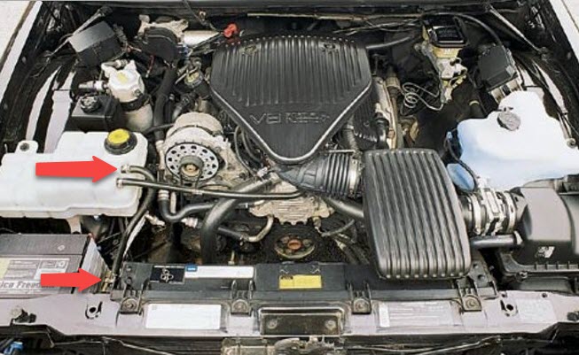

2.) "extra" vacuum lines under the hood.
one the Battery side of the engine area,I found a T in front of the radiator core support
that looks like it was a vacuum line of some sort
but the 2 open ends are just hanging there
and the other end disappears down below the
fender metal under the battery.
Any idea what this "Was" or "is" ?
3.) Plugged off, small hose on top of the Right hand side
radiator tank : There is a small hose that is cut down to size inches and
has a bolt plugging the end. Is this an
"Upgrade" or should this go somewhere?

2. Probably went to your charcoal canister. You should take a look and hook it back up if so. It'll absorb a lot of gas smell.
3. That line isn't needed. I forget exactly what it is but someone here more knowlegeable on LT1s can probably chime in. The new tanks you buy now no longer have it. They did away with it.

Prob for the evap canister that is located under the inner fender (under the battery)..do you have a check engine light on? If not, did someone pull the bulb from the cluster?

Someone put a 94 tank in place of your 95-96 one. it had an extra hole going to the radiator. You can get a new tank on eBay for $100 or so.

The extra port on the coolant tank is for the throttle body heater. It is not needed, and most people eliminate it.

I figured he was talking about the extra one...I did the TB bypass but still have my hose going into the steam pipe.
