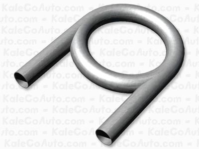

If you really want to go first class, you'll need the O-pipe from Kale.  See:  http://kalecoauto.com/index.php?main_page=product_info&products_id=41

Amateur hour.
First class is direct exhaust injection. 100% efficient:
