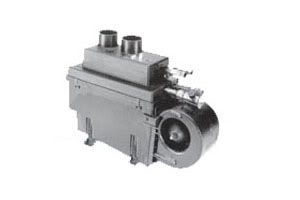

Could you make this work?
http://cgi.ebay.com/ebaymotors/Harrison-EBA-268-78B-Rear-Air-Conditioning-Unit-86-GMC-_W0QQcmdZViewItemQQhashZitem2eb4d16f7bQQitemZ200602120059QQptZMotorsQ5fCarQ5fTruckQ5fPartsQ5fAccessories#ht_551wt_946
the price is right. I have thought about this as well. Didn't they make some full electric units, independent from the factory compressor?

That looks like a roof-mount unit for an older Subureban. It might could be made to work, but I think a smaller box with two round openings for vents will work better in this car.
If I do this it's going to be a fall/winter project when work is slower over at the a/c shop. Will have a make a lot of custom hoses and do some fab work, and I think I'm going to replace the compressor, accumulator and orifice at the same time.
The compressor is quiet at the moment and throwing snowballs out the vents, so I'm going to use it as-is through this summer.
