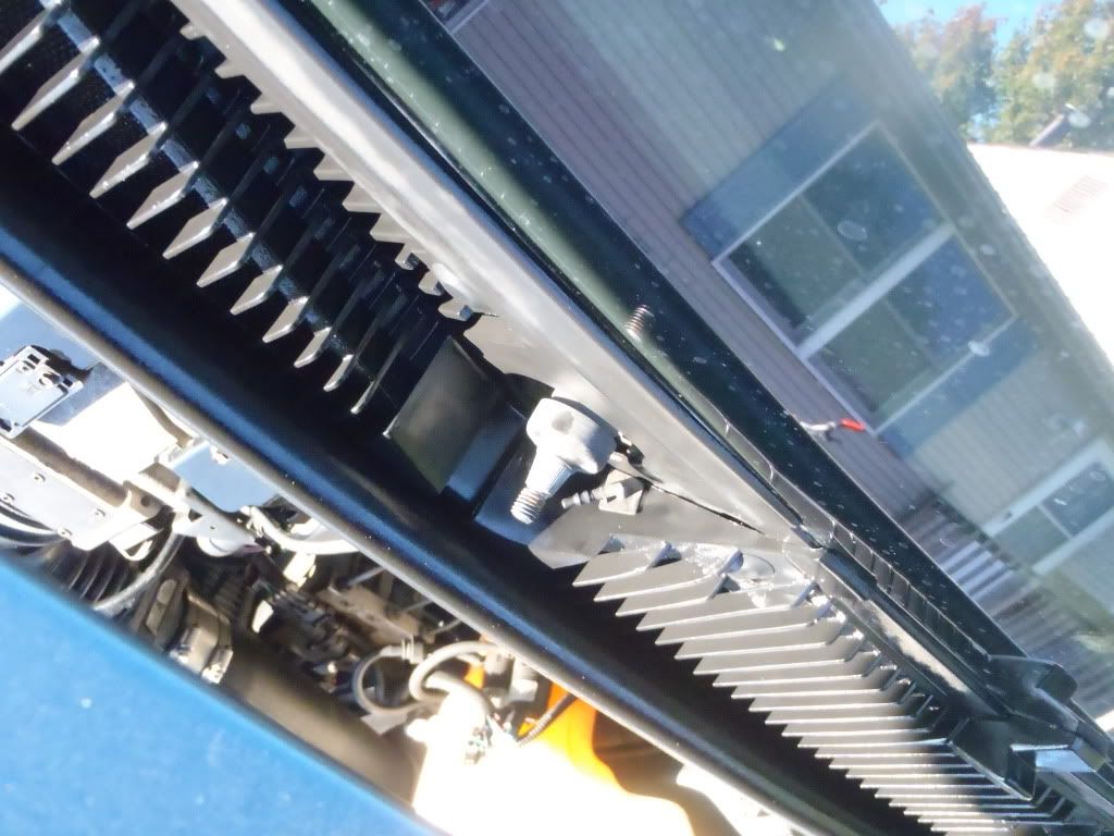

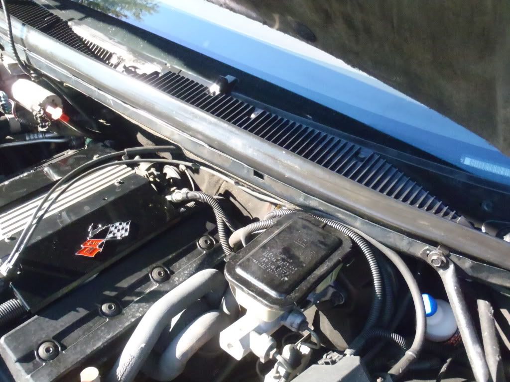

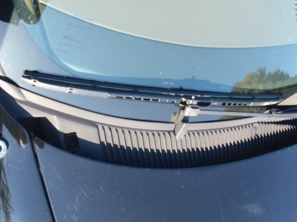

Remove your wipers
200OZ Cabin Filter Install PA080095
200OZ Cabin Filter Install PA080094

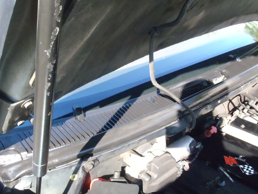

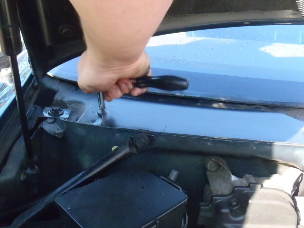

Remove hood seal carefully. Remove your cowl cover with the proper tools. A door panel removal tool works for the push plastic pins. Be sure not to lose the sheet metal screws, as they are unique to this piece. 7mm I believe.
200OZ Cabin Filter Install PA080093

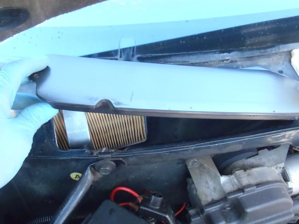

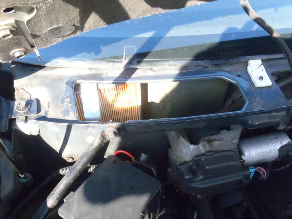

There is a small cover on the passenger side with two screws holding it down. Remove this cover.
200OZ Cabin Filter Install PA080087
200OZ Cabin Filter Install PA080088
200OZ Cabin Filter Install PA080089

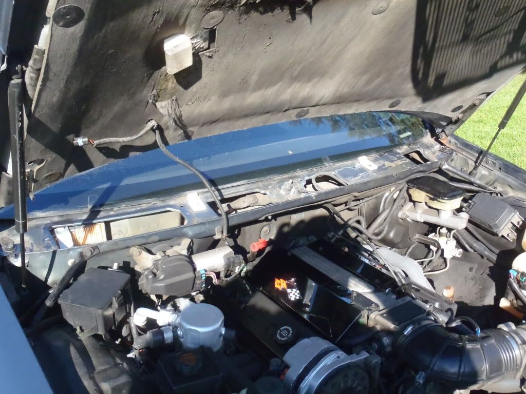

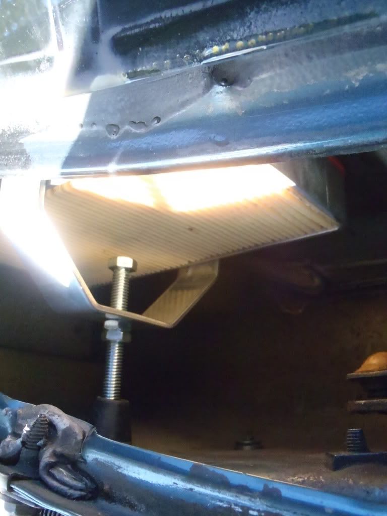

Install the filter.
200OZ Cabin Filter Install PA080092
Cover goes back on. And reverse the order of the install.

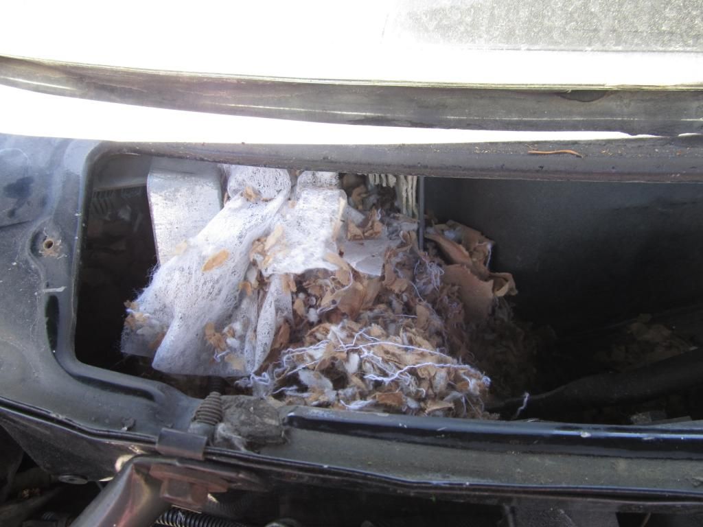

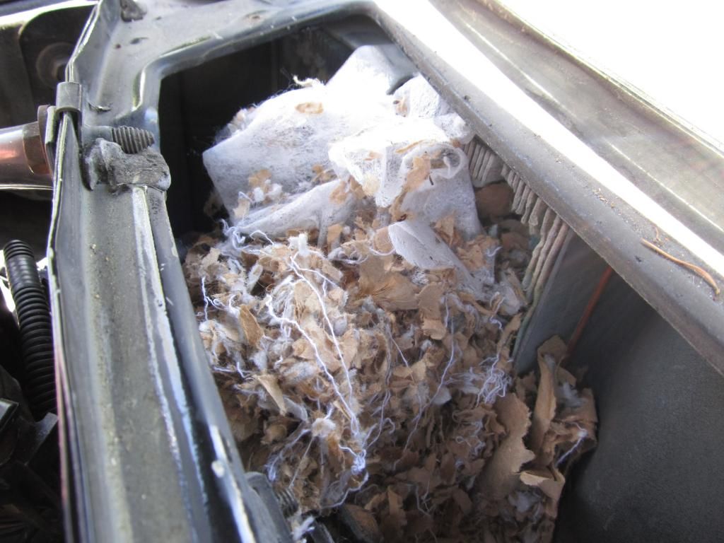

Bringing this back from the dead.
So I got my car out of my friends barn a few weeks ago, and I smelled a slight odor of mice....
Neutral That smell got worse in the last few day so I started tracking it down.
Found a nest.... Nice.
200OZ Cabin Filter Install IMG_0849_zps9fd08afd
200OZ Cabin Filter Install IMG_0850_zps24ecf285
I used a few mothballs in storage, and dryer sheets, I heard mice don't like dryer sheets....
Looks like the boogers grabbed one and used it in his nest.
Anyway the dryer sheet, and filter media provided some nice bedding for them, figured the metal screen mesh would have stopped them.
Nope. Back to the drawing board.

Mike, just pondering this a bit this morning. I don't think you're going to find ANY air filter that will survive mice chewing. Maybe what you ought to do is just include a metal plate with your kit. If the car goes in storage, replace the filter with the metal plate, and stick the filter inside the car on the dash or something as a storage reminder. The mice probably will not chew through metal. The cost of making a metal plate oughta be cheap enough to keep the total kit cost reasonable.
In other news, I was helping my neighbor restore an old commercial walk-behind mower that had been sitting outside for a few years. One of the casualties was that mice attempted to chew through the gas cap to get inside the gas tank. They stopped at the metal breather cover inside the bottom of the cap.
BTW, your buddy's barn needs a barn cat... or lots of mousetraps.
