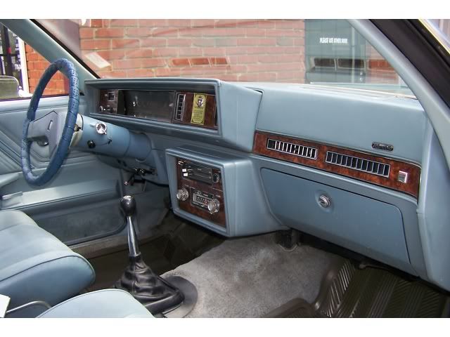

Car is listed on their lot for $10,890,. no build sheet,. so i question the 5 spd,.People add transmissions to cars all the time,. ,.. imagine in the year 2025, some one rolling out a roadmaster wagon with a 6 spd in it,. with no spid label etc,. it MIGHT pass as a factory conversion,. gerry's ls7 car might definitely pass as a gm 1 off,. his even has the correct spid label,. although record keeping is far more advanced today than it was 20-30 years ago,. i could see in my minds eye, a guy with a doggy 260v8 diesel cutlas,. swapping it out for a 5.7,. (lots of them around with goodwrench stickers on) then in 89 finding a complete 5 spd setup from a 260v8 gasser 442, and just swapping everything over,.easy bolt in stuff,.
car is cool,. i would be very interested in this car, if it had air,.and was priced a little more reasonably ,.
about 50% of asking,..

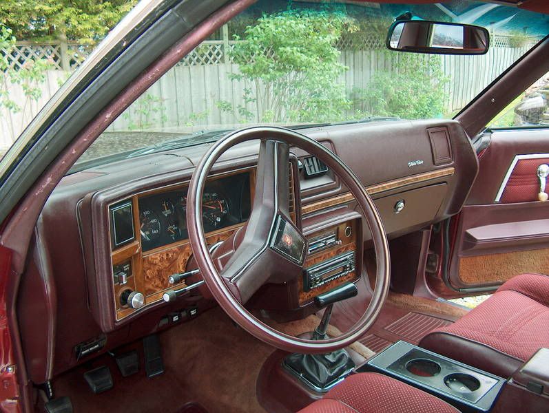

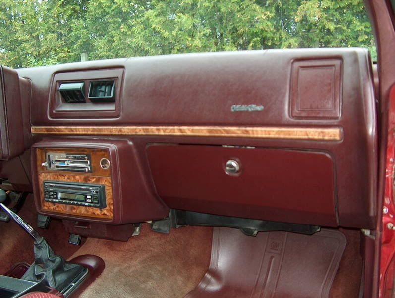

there are sites where it's vin number can be decoded vin#3R47P9M588229
other than the engine the car seems original, and in 79 the olds cutlass was the only G body that was available with a 5 speed. I thought it was only available with the 442 package and only behind the smaller V8s and V6s, but I could be wrong. however the location of the shifer in this car seems a bit far to the right when compared to other G body's manual shifter locations of the time.
Nick if you want a nice clean G body with a factory manual 4 speed, near the price range you quoted, one of our more quiet forum memeber from Parkhill Ontario has a very clean 1980 Malibu Classic sport coupe two tone claret and dark claret with a dark claret interior, factory buckets, factory tinted glass, coloured keyed seat belts and floor mats, Manual shift console, full gage instrumentation tach/clock oil temp and volt gages it's very clean inside and out, originally a manitoba car stored winters, so No rust!
the bad is the dash is cracked, and being a manitoba car it's A/C delete it has a strong original 4 bbl 305 with recent stainless duals

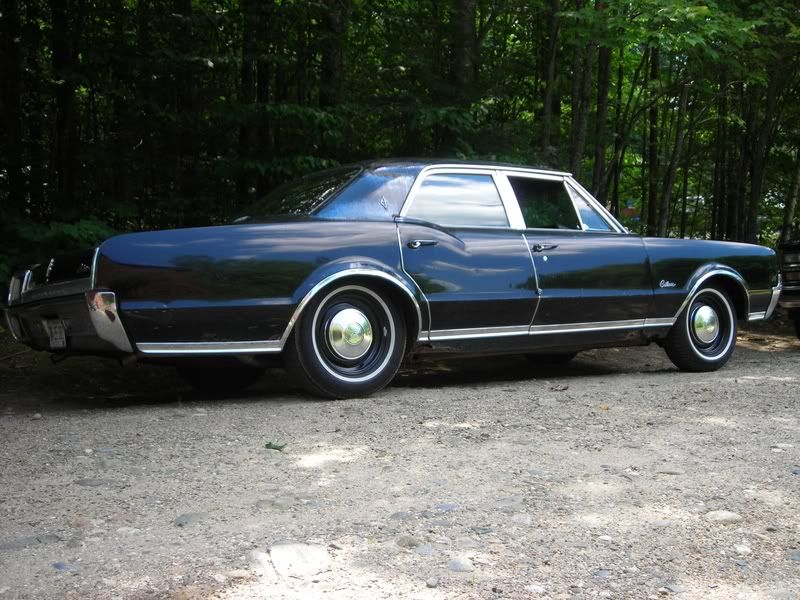

I don't think that was a factory color nor that the hubcabs OE.... Cutlass hubcaps I've ever seen covered the whole wheel and had a body color insert around the edge....with black wheels under.
It may well be a unicorn but doubt it's 100% stock.

did some vin checking,
it is a cutlass supreme, so some trim is missing, I'm not entirely sure but I think that in 79 all supremes came with vinyl tops full wheel covers.
it did come with the 4.3L deisel but the vin info I found did not mention trans information.
I doubt it's a unicorn, more like a rare cutlass supreme that some fool stripped down thinking they were making it "more" special
still a nice car but not worth the money, at most it's only worth it's original sticker price.

I kinda think it's original. Have seen basic Cutlass models with dog dish caps and not landau tops. I know the 5-spd was optional and the shifter looks exactly like the setup in late 70's El Caminos. The fact that it has the nicer buckets and cloth is a little shocking considering it's such a low option car....you think it'd be a vinyl bench....but maybe the buckets came with the stick option....
No tilt, no power windows or locks, base gauges and steering wheel, no a/c, that is really an oddball!

Mike, the shifter in this cutlass is too far to the right to be exactly like those in elcaminos from the late 70's. This cutlass's shifter is centered over the transmission, it's shifter bezel seems to be kinda floating and not flush to the transmission hump.
That don't mean that it's not correct since the olds five speeds where different in many ways than those used in elcaminos and malibu of the same vintage
where as the normal location of the shifter on G bodys of the era was off to the left of the transmission hump with it's bezel tight to the floor.
Also those olds dog dish caps are from 1967
the vin and the interior shows this was indeed a supreme and not a base cutlass, keep in mind that in 79 there were no options groups, the buyer picked out each and every option. Being both a deisel and a manual trans car it must have been a customer's special order it's doubtfull that this was ordered in by a dealer to fill the lot, cause it would have sat on the lot a long time back then.
Sounds like a pretty nice car,. cept the 305 and no air,.be good for a LQ9 T56 swap,. now if it were a dizzle and air,.who's car is it?
The heater box is broke on the blue car,. why?? maybe someone was careless when they swung that dizzle in there?? I,m pretty sure all cutlass's were supremes' in 79,.and yes the car is a P code car,.

You may be right about the shifter. Kinda surprised someone would go to the trouble to put the 5spd in there, but it might be owner-added.
As for the dog-dish caps, I'd thought they used those all through the 70's with little changes. Had a friend growing up who's parents had one of the ugly Cutlass "aeroback" sedans that I'd swear had these caps...but maybe his Dad added them....or I'm getting senile. Smile

PostSubject: Re: Weird Cutlass   Wed Oct 19, 2011 8:59 am
Only thing better would be a 5.7 dizzle 5spd el camino,. then i,d be on it like white on rice,.
i thought that too about the heater box until i guessed it was a heat shield much like the 78 elky i had had on the side of the ac suitcase
