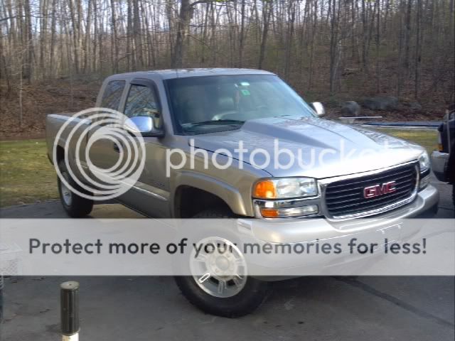

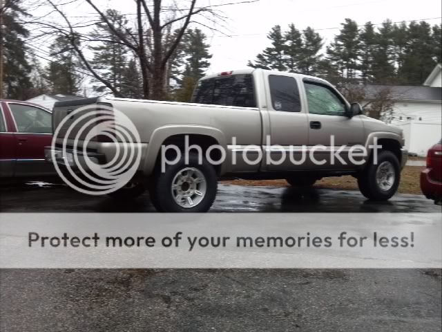

So I've done quite a bit to the truck since I last posted. Yesterday, I took it to my mechanic and had him go through it. He replaced both front hubs, all 4 shocks, an inner tie rod, an upper ball joint, idler arm, and idler arm pivot (all Moog). Then I had my buddy install a remote start and keyless entry for me too. Yesterday was an expensive day.
Since I had all that done, and today was supposed to be a beautiful day in the hugh 40's, low 50's and sunny, I took it off to get some more done on the truck. Not going to have many more days like this this year! First thing I did was have it aligned, so I wouldn't kill my new tires. Man, it rides a lot nicer now, and my steering wheel is straight again! That was driving me nuts!!!! It rides a little firmer with the new shocks (Gabriel Ultras) though. But I can live with it. And all the play in the wheel is gone!

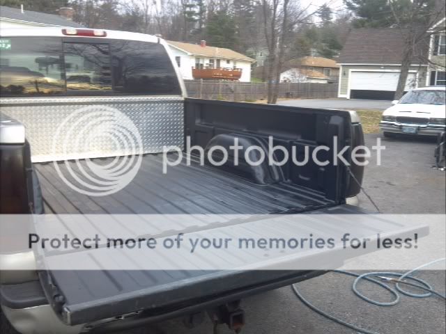

So on my way home from the alignment shop, I stopped at Autozone and picked up some Rustoleum spray in bedliner (because I wanted the bed all one color and was too cheap for a bedliner!) and Rustoleum lense tint (because I wanted to see if it really was better than that VHT crap). Then I hit the spray-it-yourself carwash to clean and prep the bed for paint. I used the free vacuums to get the loose crap. Then I used their spray degreaser in the bed. Then the foam brush. Man I feel bad for the next guy to use that, and that is why I NEVER use those brushes on anything nice! You never know what the last guy did! And then I high pressure rinsed it and headed home.
I started by removing the back rack and then blowing air all through the bed with my compressor to dry it and blow whatever loose stuff was left out. Then I red scotch-brighted the whole thing. Then I rubbed the whole bed down with isopropyl alcohol to degrease and prep for paint.
Then I taped it off. In retrospect, I should have masked more and papered the sides of the truck. Doh!
Then it was time to shoot it. I didn't really like the way it was laying down. It was very hard to get a nice, even coat out of it. It either came out way too fast and ran like a mofo or came out as mostly propellant. I did my best and laid down a few coats as I worked my way down the bed.
It acutally flattened itself out pretty good as it dried. Also got less and less glossy. I can't wait to see it tomorrow. It got too dark to see how it's gonna end up.
When I pulled the tape, there was overspray EVERYWHERE! Oh NOES!!!! So the whole truck pretty much got a bath with the isopropyl to get all that off. Doh!

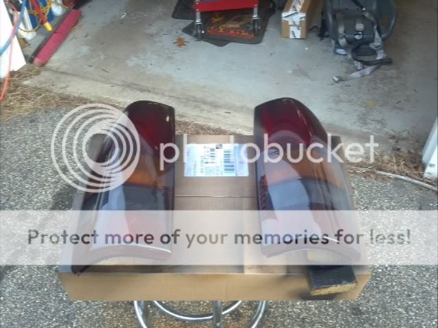

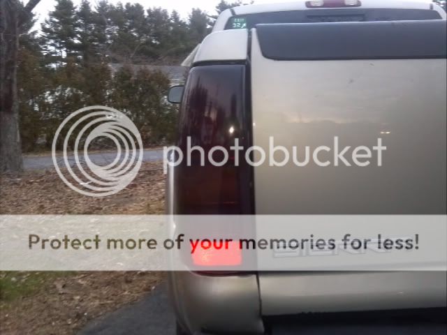

Then I decided to try out the rustoleum tint on the tailights that came on the truck. I figured "why not?" I couldn't make it worse than the first attempt. All I did was wipe the lenses down with isopropyl. No sanding. And it was too cold. And it was too windy. And the sun had gone in. But I just don't learn. I layed down one coat.
And it came out PERFECT. With NO CLEAR. Rustoleum is a superior product. FACT!!!!

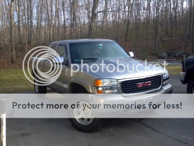

Since I still had some daylight left, I busted out my heat gun and got rid of those super ghey 4x4 stickers. Yes, it is quite apparant that it is a 4x4. So why??? Then I installed the tails too. Probably too soon, as they had only beed drying about 45 minutes. But as I mentioned previously, I'm not too bright...
Yeah, that looks MUCH better!
I was hoping that my diamond plate and projectors would show up this afternoon, but I wasn't that lucky... Boo. Maybe tomorrow? I actually kind of like it without the back rack... What do you think?
Since I still had some light left, I cleaned all the windows inside and out and then I installed my stereo that I had in the old truck. So much better inside now, too! All I have left to do in there is install the seat heaters I bought. Hopefully soon!

AMAZING transformation. I really like the RWL tires. Tail lights came out GREAT!
If you decide you're not happy with the bedliner spray, you can get a can of bedliner stuff at Home Depot that you pour in a paint tray and use a paint roller to apply. Buddy at work used it and it looked like he'd paid a pro to do it.
Really is a sharp truck. Glad you're having fun with it!
Oh PS are you putting Z71 stickers where the 4x4 ones were? Every redneck doofus down here does that, even on 2WD trucks, which is what 99% of the pickups are down here. Rolling Eyes

Yeah, they had the roll one one there, too. But that was going to end up being about 75 bucks. This was $30. Wink Besides, I wasn't looking for real protection, I just wanted to make the bed a little less ugly and maybe not so slippery for cargo. Goals achieved. lol

So you have a favorable opinion of the Rustoleum lens tint? Smile
Glad I could assist (somewhat).
PostSubject: Re: The SLuT, part Dieux   Sat 3 Dec 2011 - 0:44

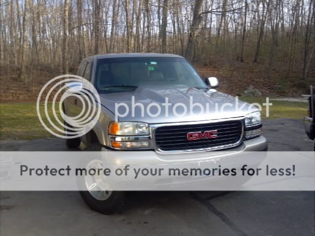

It looks 2wd now.
PostSubject: Re: The SLuT, part Dieux   Sat 3 Dec 2011 - 0:53
Yes I do. Thank you! Very Happy
Bewber wrote:
It looks 2wd now.
*sigh*
Yes. Yes it does.
PostSubject: Re: The SLuT, part Dieux   Sat 3 Dec 2011 - 0:58
A lifted 2wd though!

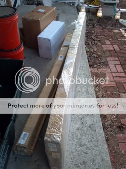

It's like Santa came early this year!!!!
I threw the bedcaps on already. Was too dark for pics. Will be doing the headlights, tailgate cap, nerf bars, and intake throughout the week... Wink
Dropping off the hood at the body shop tonight!!!! Very Happy
