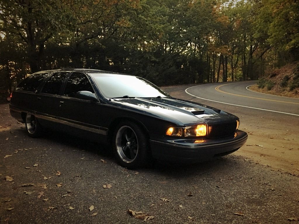

jasonlachapelle wrote:
nice work.  What do you think of the brace ?
Thanks! The Hotchkis engine bay brace really seemed to tighten up the fenders and hood. It actually made the ram air hood fit flush and sit even. The frame/swaybar brace seems noticible (to me at least) when I'm hitting those tight hard corners. The wagon feels more controlled through the corner. Could all be in my head...but I'm pleased!
Drove it hard today through the mountains and loved every minute! Made it back down before sunset.

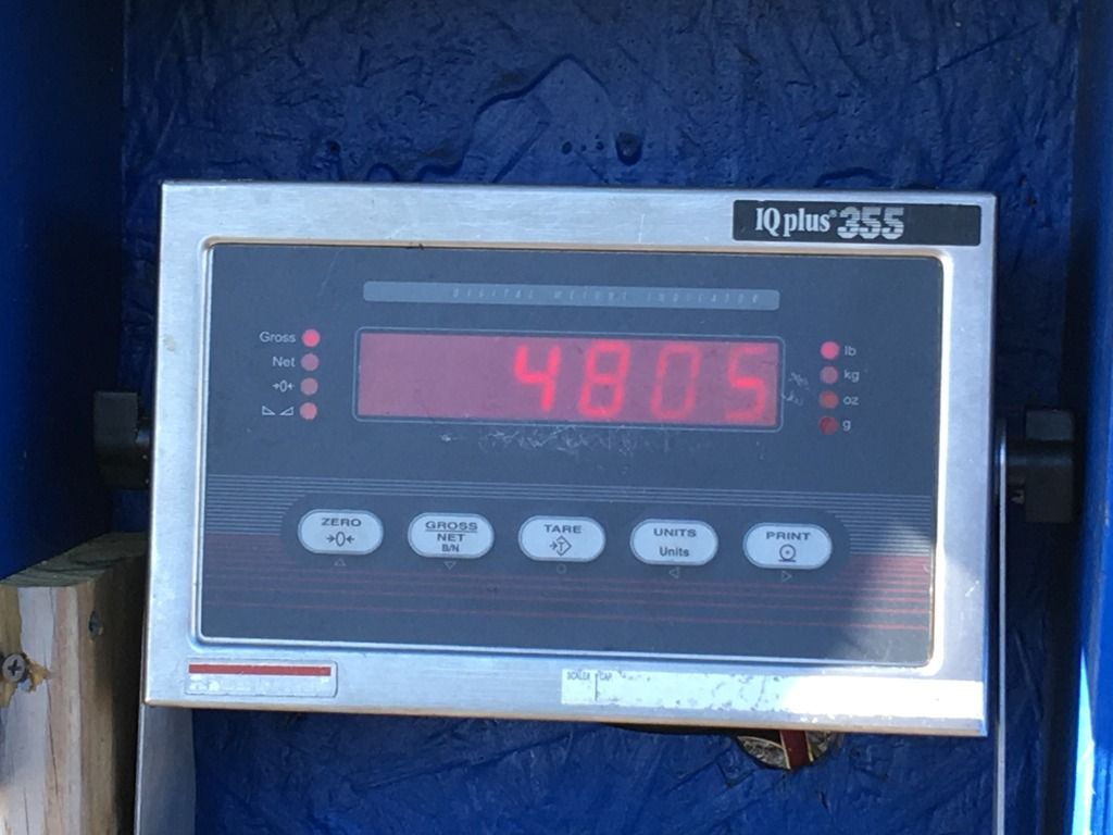

car looks great have you ever weighed it before and after?
Posts : 3313
PostSubject: Re: Getting Jade Ready for WagonFest (and other updates as they come)    Mon Oct 31, 2016 9:08 am
Eds rmw wrote:
Sweet wagon ! We are local each other, would like meet up sometime
Sounds good to me!
Not since last fall at SSHS.  This thing is a pig with me in it (4,805 lbs) but was still able to pull off 14.9 in the quarter.  Since this weigh in I have changed the suspension / control arms / brakes (rear disk)/ added the braces and swapped to an aluminum driveshaft.
I did have a mostly full tank, floors and side panels covered with the Peel'n Seal sound insulation...amp and sub in the back wheelwell area.
Unfortunately I have two gigs during SSHS this year...so no weigh in to compare.
