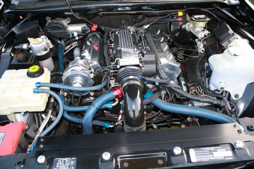

PostSubject: Re: Heater Hose questions   Mon Jul 16, 2012 6:28 am
Ancient_1 wrote:
Goodyear makes a complete set of hoses for our LT1 cars. Only thing I don't care for is the blue color.
I put mine in sleeves
PostSubject: Re: Heater Hose questions   Mon Jul 16, 2012 8:18 am
I like those fittings on yours, Tim.
PostSubject: Re: Heater Hose questions   Mon Jul 16, 2012 9:03 am
Cheap aluminum covers. Going to remove soon and go a different direction. Very Happy
BTW..... JAYSS makes the plastic restriction part in Billet aluminum. Nice piece!!
