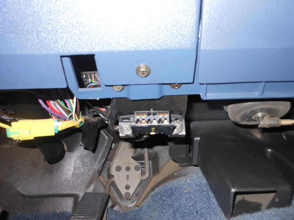

I know I'm dumb but where is the location of the plug in for the Diagnostic Computer thingee? I just had to ask.
PostSubject: Re: Diagnostic Location   Wed Aug 01, 2012 11:31 am
Bottom of the dashboard, to the right of the steering column.

FYI... The "thingee" is formally called an ALDL or DLC depending on what year you are talking about. The ALDL is the Assembly Line Diagnostic Link and the DLC is the Diagnostic Link Connector.
The ALDL was used on most of GM's car, as shown in the picture above, until about '94 when they slowly started to phase-in the OBD II style connector, DLC. So the 1994 car could of had either the ALDL or DLC. Pre-94 it was almost guaranteed that you would find the ALDL style connector.
Some of the 1994 vehicles that have the newer style DLC are still ODB I compliant, but in 1996 all cars are ODB II compliant and will have the DLC connector. The pin locations in the connector are standardized to meet ODB II regulations. As an example; pin location #2 is for Class 2 communication, #4 and #5 are ground terminals and #16 is battery power all the time. As a word of note, DO NOT USE the ground and power from this connector for any aftermarket accessories.
Also in 1996 the location of the DLC also became standardized in its location, it has to be within a reasonable reach from the drivers seat. Prior to ODB II, the location of the ALDL could have been located anywhere on the vehicle.
