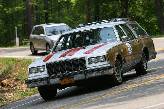

Found this forum from my time spent on the Impalassforum.  I know its not an 91-96, but Boxy wagons need a home too.
(Don't worry. The stripes are magnetic tape.)
1989 Buick Electra Estate Wagon aka Firefly.
Did the BABE (Big Apple to Big Easy) Rally in 2011.  Found her for $500 and is my first car.
She is just a faded white, Ikea wood wagon, but I still have a sentimental attachment to her.  I know it'll just be trashed if I sold it.
Two years later just under 96,500 miles and continually trying to keep her running smooth.
Time and money permitting would like to take out the 307 and put in a direct swap 455.  Keep it Olds and Carbureted. Posi the rear and change up the ratios.
Might be a bit tired, but has never let me down when it counted and not many of them on the road.
