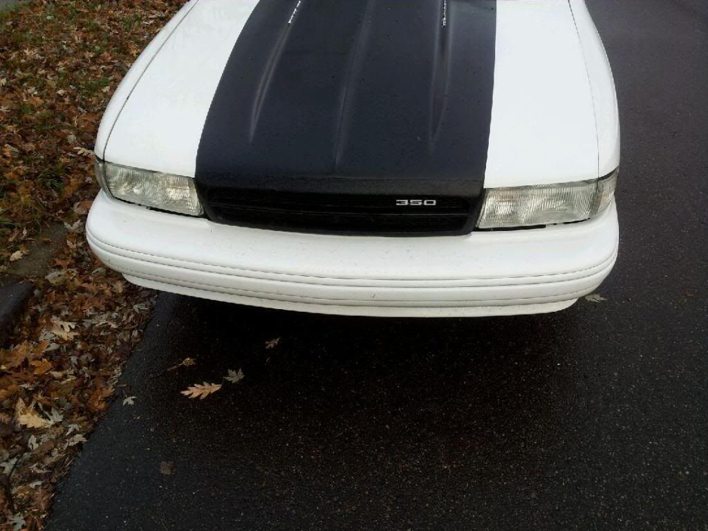

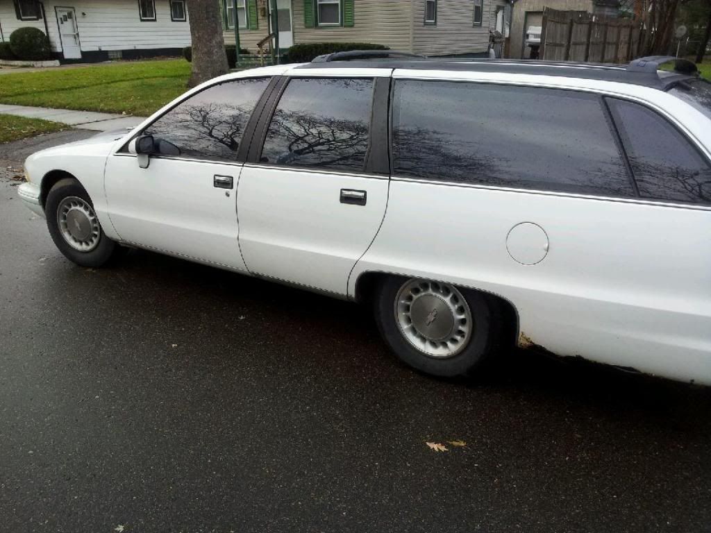

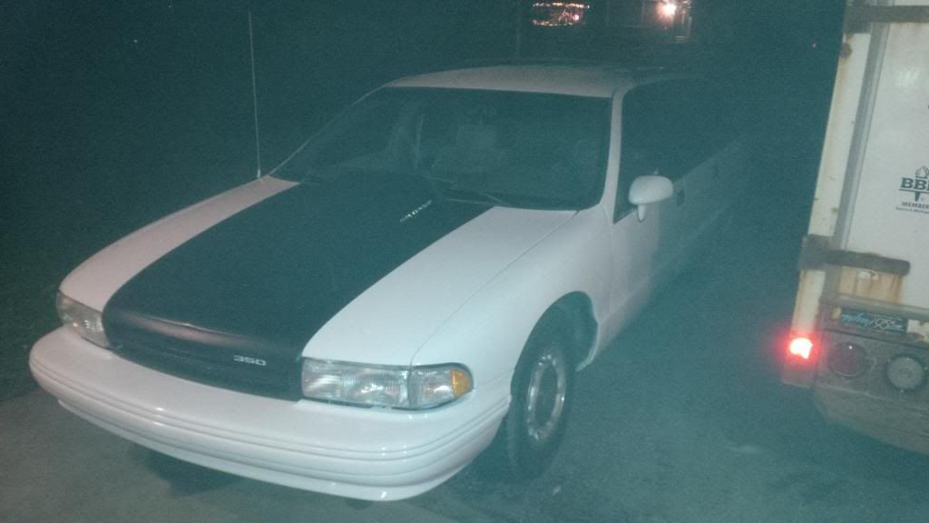

Here are a couple pictures of the white whale:
Sorry for the crappy pictures. I will get some better ones when the weather permits. There really isn't a picture that's gonna make it look good though. It is fun to drive and can haul the groceries with a quickness!
