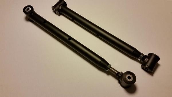

Is this where you sourced the correct trailing arms? http://southsidemachineperformance.com/t/gm-b-body-1978-1996-complete-rear-kits

You probably don't need the adjustable LCAs unless you are going to add a lot more HP and torque later. I'd go with the simpler square tube non-adjustable replacements. They are a drop in fit, and are pre-drilled for the Hotchkis rear sway bar.
http://www.ebay.com/itm/Boxed-and-welded-Poly-control-arms-lower-for-Caprice-Impala-Cadillac-Yukon-Humme-/111936613773?hash=item1a0ff12d8d:g:nk8AAOSwVFlUD3Xj&vxp=mtr

PostSubject: Re: Just following orders...   Just following orders... Icon_minitimeSat Mar 19, 2016 2:57 pm
The above part is compatible with the 1994 Caprice Wagon, so I'm guessing it would also fit the Buick. But, you could call Southside Machine and ask them to cross reference the part. I believe the OEM LCAs are interchangable for Chevrolet and Buick wagons, so I don't know why aftermarket LCAs would not be interchangable.

PostSubject: Re: Just following orders...   Just following orders... Icon_minitimeSat Mar 19, 2016 9:49 pm
Voila!  You can order them directly through Southside Machine for $155.99, and they list them as compatible with the 91-96 Roadmaster.

why does everybody have such a hangup on buying  lower control arms?
I don't think there is more than a 3 -4 people on this forum that drive their cars hard enough to need them,.
building one part of the suspension for the baja 500 makes no sense,.
Good shocks,. and adding even the clownvic rear bar makes a very noticeable difference over stock,.yes even the thinner one,.

PostSubject: Re: Just following orders...   Just following orders... Icon_minitimeSun Mar 20, 2016 11:33 am
In my case, it had a lot to do with time and money.  The stock LCAs require bracing or brackets to attach a rear sway bar due to the U-profile and stamped sheet metal construction.  If the bushings are gone on the original LCAS, you need to replace the bushings, which is an RPITA, and takes more time.  Even on the newest 1996 B-body, these things are 20 years old now.  The OEM bushings degrade quickly, and are inferior to the polymer bushings used in the Southside Machine LCAs.   By the time you've bought either, futzed with bushing replacement, or replaced the OEM LCAs with new OEM LCAs, and then welded up or bolted on brackets to attach a sway bar, you've spent at least the cost of the Southside Machine LCAs ($155 with free shipping), not to mention burning a lot of leisure time.
If you install the Southside Machine LCAs, you get a square tube profile and a flat mounting surface.  You don't need to futz with brackets, welding, or drilling.  Either the Hotchkis or the Helwig aftermarket bar will be a drop-in fit.  Four bolts and you are done.  It took me less than 15 minutes.  Yep... I could have gone with stock parts.  It would have taken a lot more time, and it wouldn't have worked nearly as well, but hey,... at least it would have cost more.  As for fitting a sway bar from a scrapyard: nothing wrong with that if you have the time.  I didn't.  I had $290 for the Hotchkis bar, and went skiing instead of spending the weekend on my back under a wreck in northern NY, hunting for a sway bar that I could make fit.  I know not everyone has that option, but I did.

PostSubject: Re: Just following orders...   Just following orders... Icon_minitimeThu Mar 24, 2016 11:19 am
Southside LCA's in,KYB Excel G's in,Hotchkis slated for first week in April. "Hopefully."

PostSubject: Re: Just following orders...   Just following orders... Icon_minitimeThu Mar 24, 2016 1:53 pm
Upgraded LCA's,different wagon. The 91 OCC sports Metcos,94 Roady will sport the Southside products.
