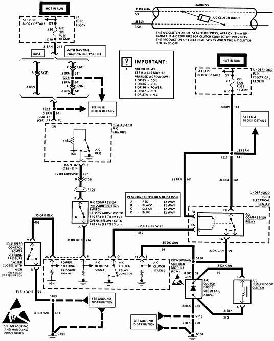

Low pressure cycling switch typically opens around 25 psi to prevent evaporator freeze up on an CCOT system. High pressure cut-out switch (if equipped) typically opens around 400 psi to prevent excessive pressure buildup in the system. I really don't think you are experiencing either one of these conditions, but I've been wrong before. Don't rule out intermittent switch operation, cycling switch is inexpensive and easy to swap out without discharging the system.
You say the system is cold when its working, therefore I think the charge is pretty close to were it needs to be. Quick test, grab the liquid line and suction line out of the evaporator, with the system operating, if they are equally cold the charge is real close to being ideal.
I do believe you have a electrical issue. Here is a diagram of the electrical circuit that controls A/C clutch operation. Have fun.
