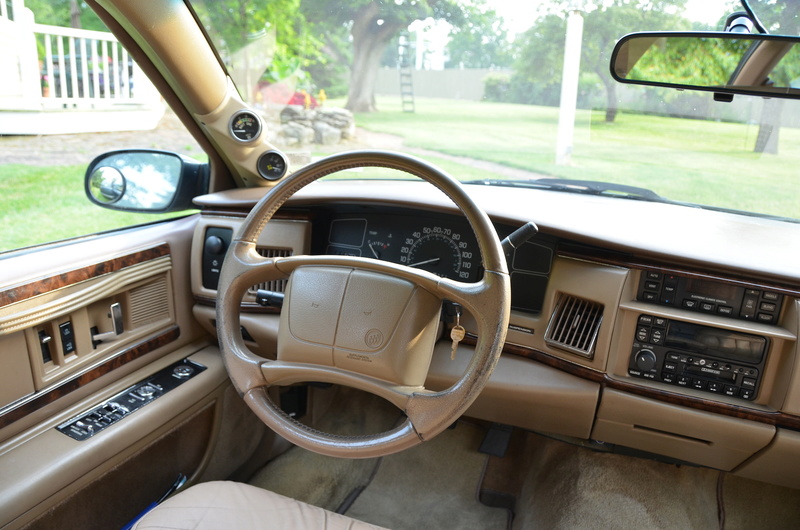

| Gauge craziness has been reduced, although I did retain the oil temperature and voltmeter gauges on the A-pillar. ![July 2017 LROM: The Viking Roadmaster Dsc_0016](https://i.servimg.com/u/f11/18/96/64/89/dsc_0016.jpg) | |

| Beautiful wagon, great write-up. I've always been confused by the gauge clusters in these cars. Why no tach or volt gauge? | |
