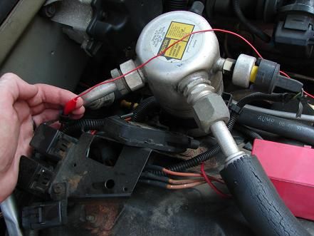

scoffman
Posts : 552
Join date : 2012-02-21
Location : Lawrenceburg, KY
PostSubject: Re: Whats the best way to drain the gas tank?   Fri Sep 20, 2013 12:34 pm
Here is a pic (not mine can't upload pics from current location) of the connector. The red alligator clip cable is hooked into the actual jumper port (black plastic connector). Do like in the pic and run the other end of the red cable to the battery positive terminal and the pump will continuously run. Be careful not to run the tank completely dry. It's located on the passenger side inner fender way back by the firewall.
